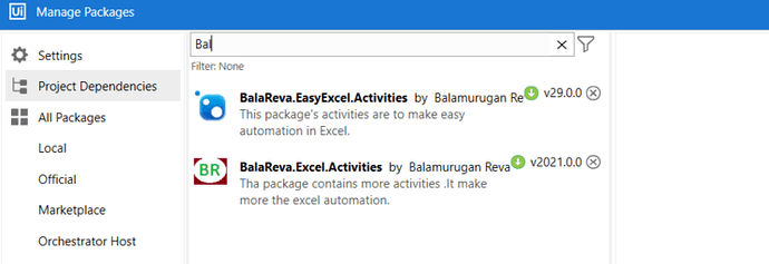

Cell reformattings can be done with Balareva Package

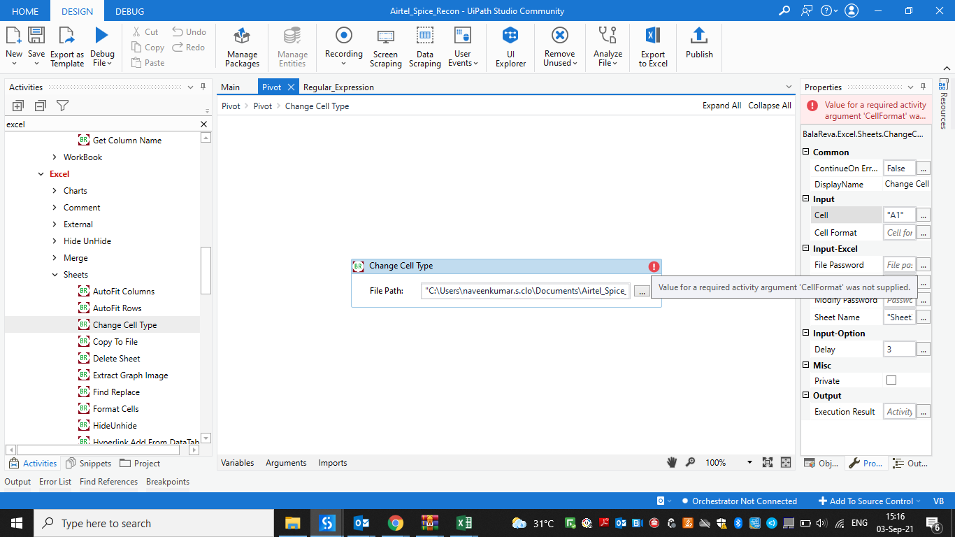

you can manually reformat the cells in Excel
Once it is working you can automate it with:
grafik
What could I mention inside Cell format??
the format that you have prototyped manually in excel when configuring advanced / custom formats
