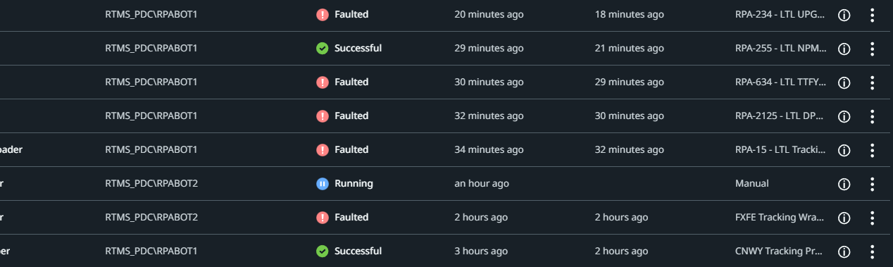

Could not start executor. A specified logon session does not exist. It may already have been terminated. (0x80070520)
Hey all,
We recently changed our processes to use parallel for each, but this causes the error within the title when the jobs try to run in orch now. It seems it will run one job, and fail any after it until that job is complete.
We currently have our machine running two bots, 1-2. And both are set not to logon to console.
@David_Hernandez2
Can you check the event viewer…
And also can you see if the vm has reached the max login limit?
Is cal license enabled?
