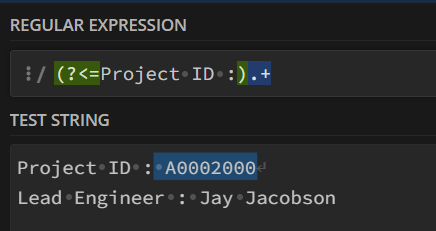

Project ID : A0002000

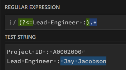

Lead Engineer : Jay Jacobson

You can use regular expressions to extract the PID and Lead Engineer name. Once you get the values just trim it to remove any leading / trailing spaces.
For project ID (?<=Project ID :).+
For lead engineer (?<=Lead Engineer :).+
Thank you @yikwen.goo It worked!
