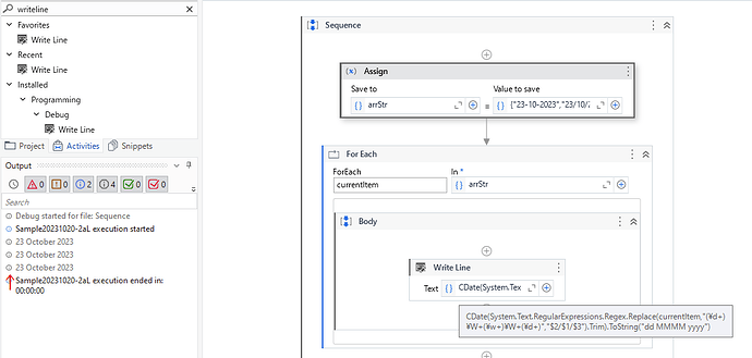

Can you try the following expression?
CDate(System.Text.RegularExpressions.Regex.Replace(currentItem,"(\d+)\W+(\w+)\W+(\d+)","$2/$1/$3").Trim).ToString("dd MMMM yyyy")
Sequence.xaml (6.5 KB)
