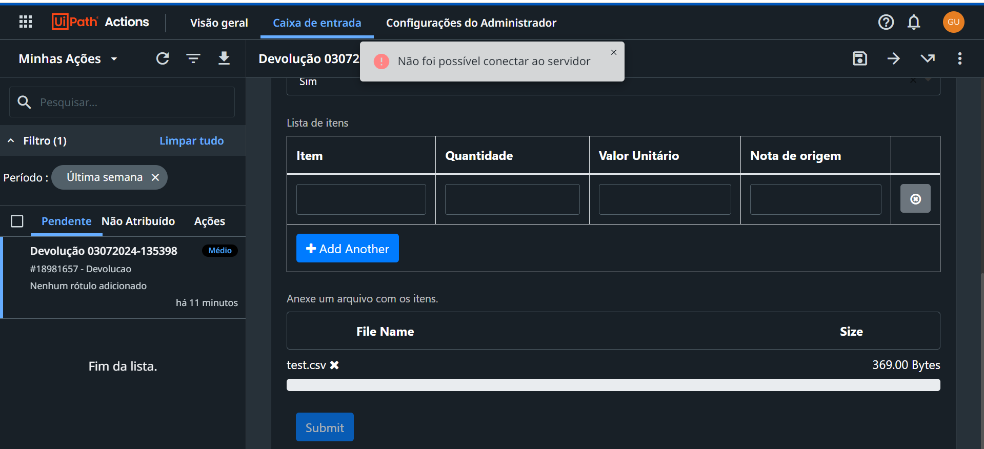

My form has file component to the user attach some files, but everytime a file is attached the Action center shows the message “It was not possible to connect on server”.
Also, after 60 seconds this message appears:
Note: I don’t think that is a storage bucket’s error, because I’m using HTML element component to create a hyperlink to user download a file from the same storage bucket.

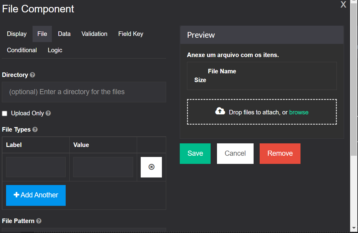

And this is how the File component is configured:
This is the first time i’m using this component, so I’m probably doing something wrong.

By the way, i have solved the connection error while attaching files. Looks like it was just a bug, i just created another forms with the same configs and workded fine!
