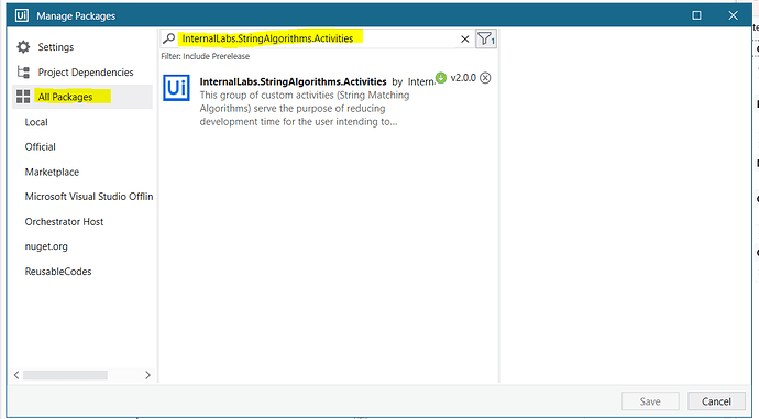

Download InternalLabs.StringAlgorithms.Activities
Then use Different algorithms
Cheers!!
I appreciate your help. I searched in the packages, and I couldn’t find it. I’m running StudioX 2022.10.4. Is this package compatible with it?
@n3if
