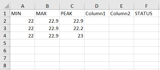

I have an Excel
I want to check if peak value lies in between Min and Max column then Column D should be filled as OK if not then HIGH
in this scenario D2 D3 should come as OK and D4 as HIGH
what will be the logic

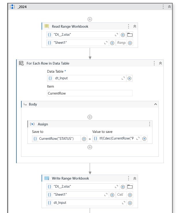

Hi @Pogboom
→ You can use the Read range workbook activity to read the excel and store in a datatable datatype variable, let’s call it as dt_Input.
→ After read range use the For each row in datatable activity to iterate the each row in the datatable.
→ Take an assign activity to check the condition and update the STATUS Column.
- Assign -> CurrentRow("STATUS") = If(Cdec(CurrentRow("PEAK"))>=Cdec(CurrentRow("MIN")) and Cdec(CurrentRow("PEAK"))<=Cdec(CurrentRow("MAX")),"OK","HIGH")
→ Use the Write range workbook activity outside the for each to write the datatable to the same sheet.
Workflow -
2024.xaml (21.7 KB)
Output -
Hope it helps!!

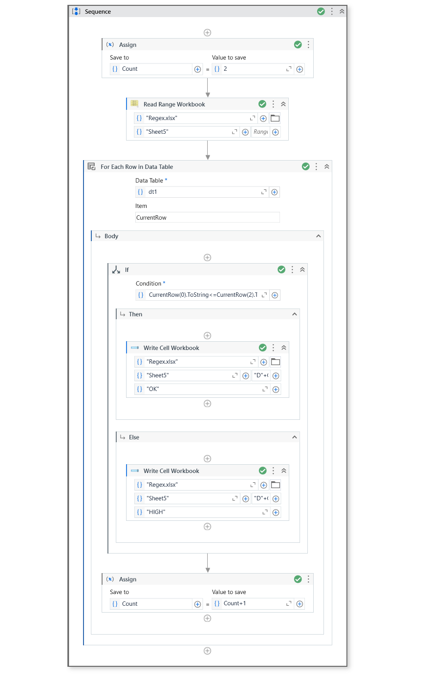

Hi @Pogboom
Please check the below workflow and it works for your scenario where ever the status column will be
WorkFlow:
Main.xaml (16.2 KB)
Input:
output:
Regards
why did you use count = 2 any specific reason? and also below you used count = count +1 didnt get that part
Hi @Pogboom
Please avoid that. I’m sorry for that confusion.
You can delete that it’s not necessary.
Regards

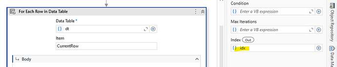

Hi Pogboom,
Step :1 Read the Datatable and Assign variable as “dt”
Step:2 Take For each Row in Data Table activity pass “dt” and take output as idx variable
Step:3
Assign
MIN=Convert.ToInt32(CurrentRow(0).ToString) for MIN variable variable aType as Integer
MAX =Convert.ToInt32(CurrentRow(1).ToString) for this variable Type system.Decimal since the data is Decimal
MAX =Convert.ToInt32(CurrentRow(2).ToString)
Assign If Condition and write syntax as “Peak>Min and Peak<=Max”
In then condition assign variable currentRow(“STATUS”) = “OK”
In else condition assign variable CurrentRow(“STATUS”) = “HIGH”
Step :4 take Write range and Pass the “dt”
I hope this will you to understand it
