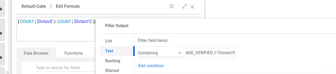

Hey Thanks again. But, I need the filtered to be a percentage of total, so this way around. Please see below when I separate both functions, I get the same value, 3rd column is filtered:

A suggestion here from my own filter explorations - when you apply a filter at the widget level (like you have in the filter pane on the right in the screenshot), it will filter everything. The way to apply a formula-specific filter is the following format:
[field 1], [filtered field1]
you can see an example of this in the processes template. check out how we do success %. to filter the second part of the formula (aka the filtered field 1), first type field 1, field 1. then click the second field 1 and select the filter option. filter what you need to, and then it will apply this filter for that field.
let me know if that helps!
Hi There, thanks again, please see the filtration.
I seemed to have found the formula/solution:
It seems you need to include the filtered data AS WELL AS the original data, before the calculation takes place.
