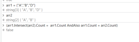

Just keep the following in mind (e.g. when a wrong check can cause damage)
grafik
the Except is 0, but arr1 is not arr2
(we keep also in mind that set operations Intersect, except will deduplicate the occurrences)
We can more strictly check with:
grafik
And also
grafik
With cross check
grafik
