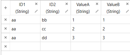

@AnandKumar26 tested it with the following example
Table 1
ID1 ID2 ValueA ValueB
aa bb 1 1
aa cc 2 2
aa dd 3 3
Table 2
aa bb 1 1
aa cc 2 4
aa qq 9 9
And it gave me
aa dd 3 3
Whereas I wanted
aa cc 2 4 → because there the IDs are the same but the values are different
Sorry, if I didn’t make the problem clear in the beginning
