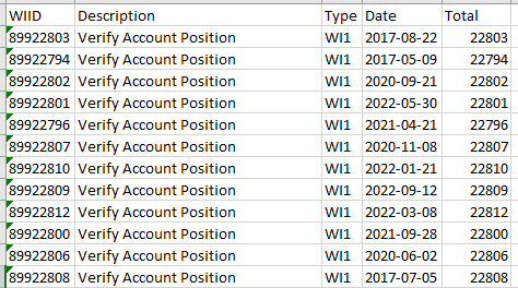

Compare common clumns of two diffrent tables and write the values. using linq method syntax
Hello @Pujari_Manjunatha
What output you want can you explain. you want to join tables on basis on WIID using linq Query?
use join datatable activity it will do the same as linq
Regards
I want to know how to write linq for it.

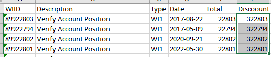

@Pujari_Manjunatha
(From a In Dt1.AsEnumerable()
            Join b In Dt2.AsEnumerable()
            On a("WIID") Equals b("WIID")
            Select OutputDataTable.Rows.Add({a("WIID"), a("Description"), a("Type"), a("Date"), a("Total"), b("Discount")})
).CopyToDataTable()
@Pujari_Manjunatha
Did you build the output datatable with the output column names?
And the column names must match with output datatable
Hi @Pujari_Manjunatha
In my case it is working
If not working please go through below link for your reference
Yes, I need to add those columns to the final output data table. Then only it will work. Thanks for suggesting.
