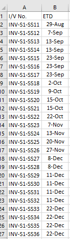

i already achieve that one… but what i need is that if there is 3 invoice number the actual date must fill the 3 invoice number with same actual date… and other invoice must follow base on actual date per invoice…

FYI. The result is saved in result.csv.

I saw the output and this is the correct data… i really need this please help

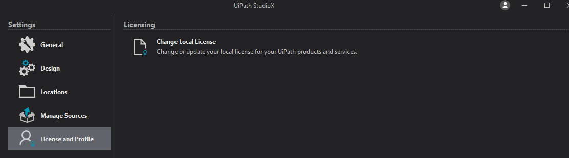

It was created in Community Version. Maybe you switch to Studio from Studio-X then you could open it.
i cannot change profile…
I guess your license is Enterprise?
