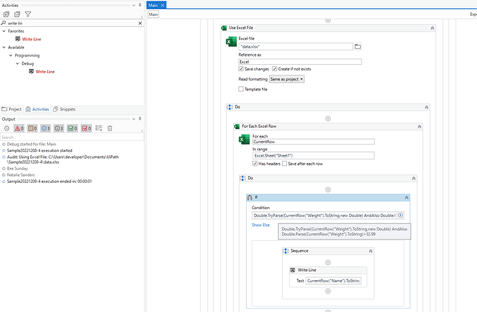

@Rahim_Bhatia you could be if
weight.isnumeric and cdbl(weight) >32.99
Hope the following sample helps you.
Double.TryParse(CurrentRow("Weight").ToString,new Double) AndAlso Double.Parse(CurrentRow("Weight").ToString)>32.99
Sample20221208-4.zip (9.4 KB)
