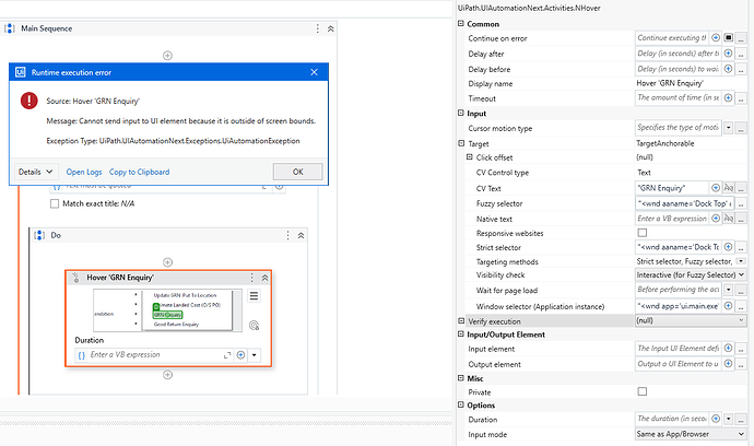

Thank for the reply. I manage to HOVER to GRN Enquiry. When I debug. I receive error message. Is there any setting I need to set in properties.
Hi @yee68
Before Hover activity add a Click Activity indicating the Purchase Menu to bring the options for Hover Activity
After I set window resize to “maximize” in Use Application activity. I receive “Can not find UI element”
Try to reindicate the element and try again
You can also try using Verify Execution property to verify that click has been performed before proceeding ahead.
Thank for all replies. After I click purchase menu and still hover can not find “GRN Enquiry” element.
