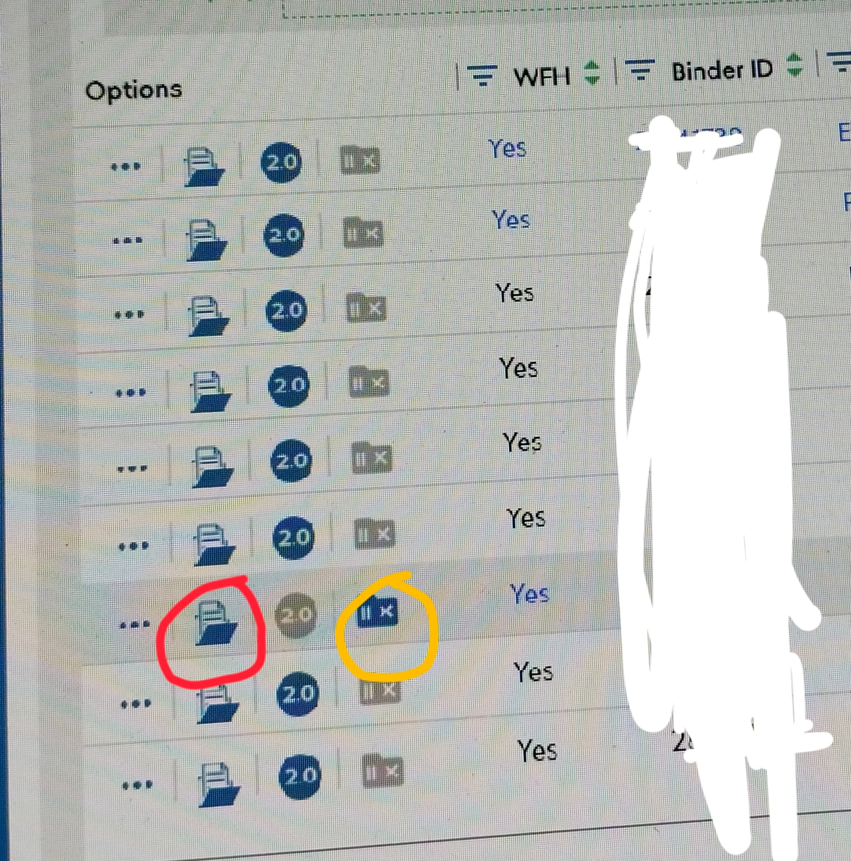

Here is a process, we click on folder icon on the first row (marked in red) then we have to click 3rd icon(marked in yellow) besides 2.0. But what happens once the browser refreshes then first row value goes down. Our flow has idx as 1.
We dont know where it will go it can go anywhere below.
Every transaction has respective binder id. So it should only click to that icon with respective binder id.

You can create a selector with the binder id as the innertext so that even if anything changes based on binder id it would pick
Eg:
<webctrl tag='TD' tablecol='5' innertext='{{binderidvariable}}' />
<nav-up='1' />
<webctrl tag='TD' tablecol='2' />
Or
<webctrl tag='TR' innertext='*{{binderidvariable}}*' />
Assuming binder id column is 5 and the folder click column is 2
Selectors are for reference…use ui explorer and find the selectors…nav-up is an addition to make selector look one level up
Hope this helps

Would it click the third option accordingly?
First it clicks the option in red then it has to click third option
But after first click, it refreshes
Sorry the first image is confusing, this is the actual image.

Yes it can …even if it refreshes the number we are using is same right…so vhange the tablecol value as you need

Yes please use the same…also if you check in the middle panel of ui explorer you would find tag tr as well whichw ill contain the binderid you need
