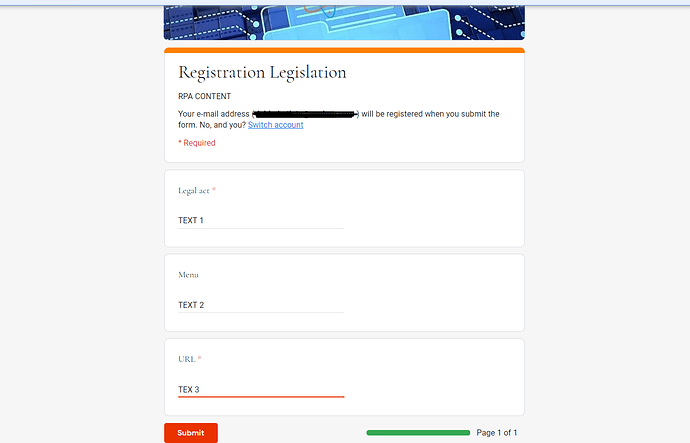

Every day on a website, I need to click on multiple links only from the condition current date and within each link, I always Get 3 texts and type into the Google form.
How how to make this? Example bellow:
1- Click on each link in the current date
2- Get the 3 texts inside the link
3- Type into Google Form (3 text)

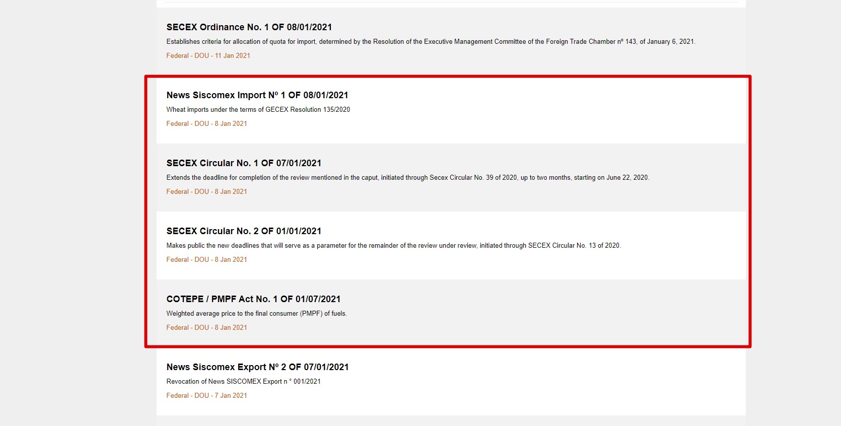

Importantly, this action of Get text of the links, has to be ONLY OF CURRENT DATE OF THE DAY, probably has some condition. in the case of the print action example only for January 8

In summary, I need Click day by day in each link of de current date of the Day , and get 3 text inside each page. in the case of the print action example only links for January 8

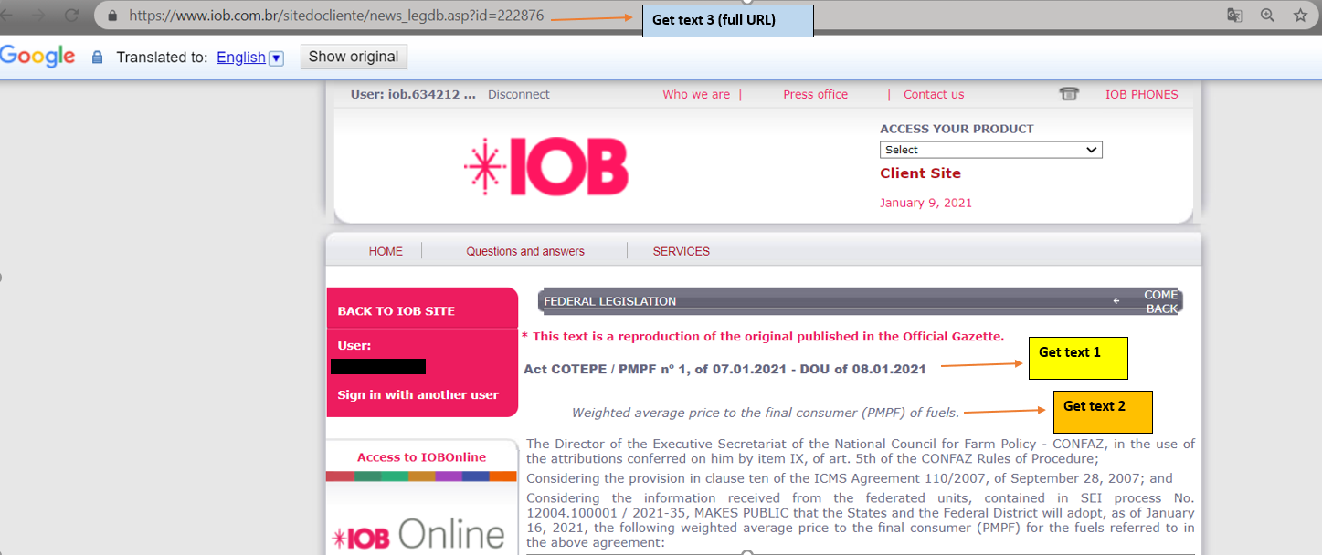

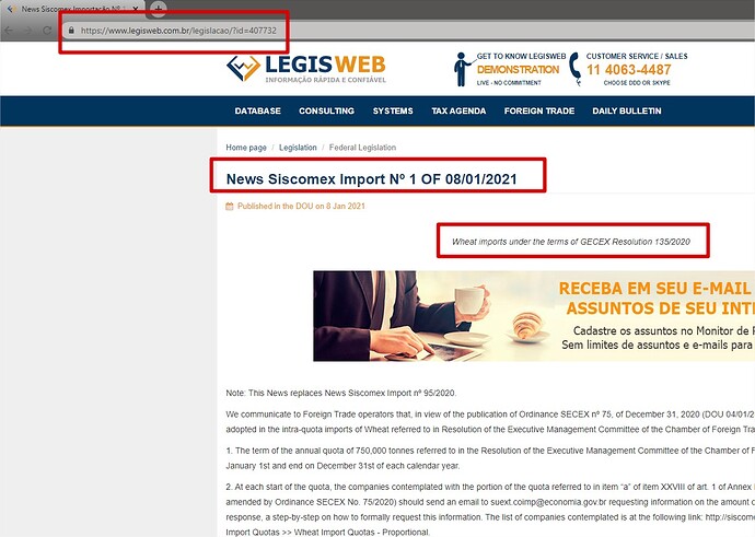

Find link:[Legislação]
In this example, I need to click only the date of January 8th (4 links)
Get Text 3 text:
Thank you!!!

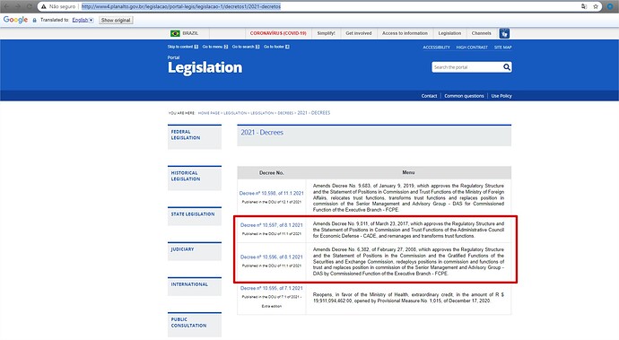

Try this…
http://www4.planalto.gov.br/legislacao/portal-legis/legislacao-1/decretos1/2021-decretos
click only “currente day” examples 08/01/21
Each Link …Get 3 text and type into on Google Form
