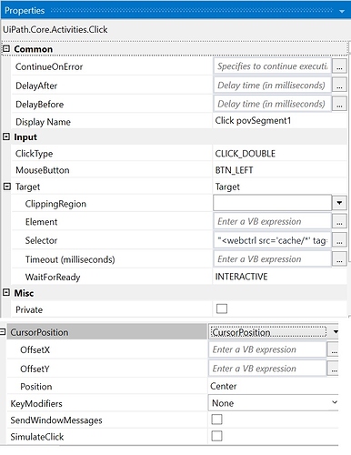

Sorry, I forgot to include screenshots of the Click and Type Into properties. Here is the Click. (Note: I currently have it set to Double Click, but single produced the same result.)

Yes, I was facing similar issue in my first ever experience with UiPath: the selectors were correct (then no exception raised) but the focus was not moved and all typing was in the same field :confused:
Since you have to disable Simulate Click/Typing and you’re in a web page, you might consider JavaScript “injection” but that require some “reversing”.
