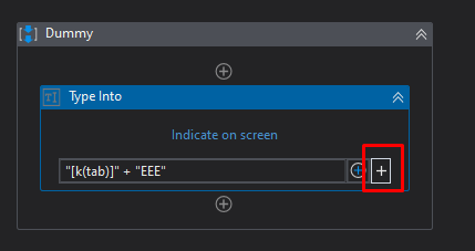

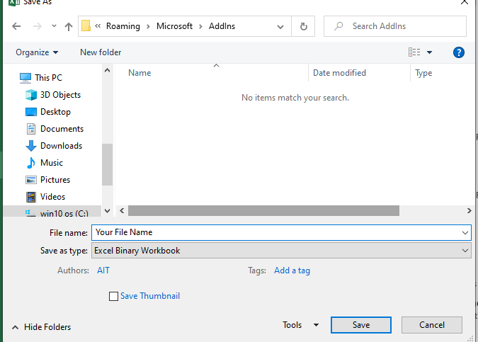

Hi @gabriela.sindelova
You can try with following steps:
Step 1: After entering the File name.
Step 2: Use Special Key in Type Into Activity
"[k(tab)]" + "EEE"
Step 3: Use Special Key in Type Into Activity and Click Activity to select the format
"[k(tab)]" + "[k(down)]"
