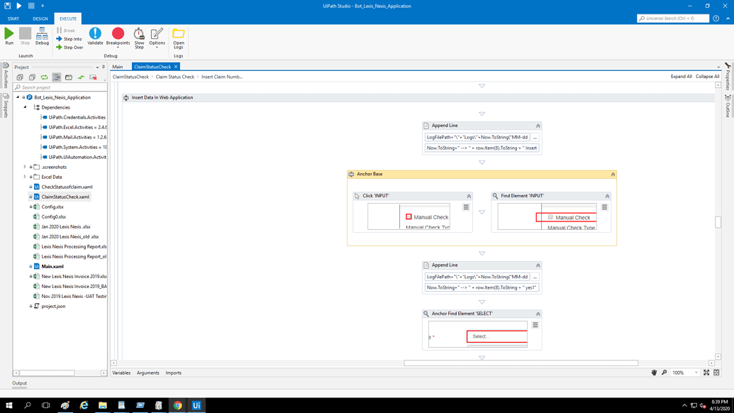

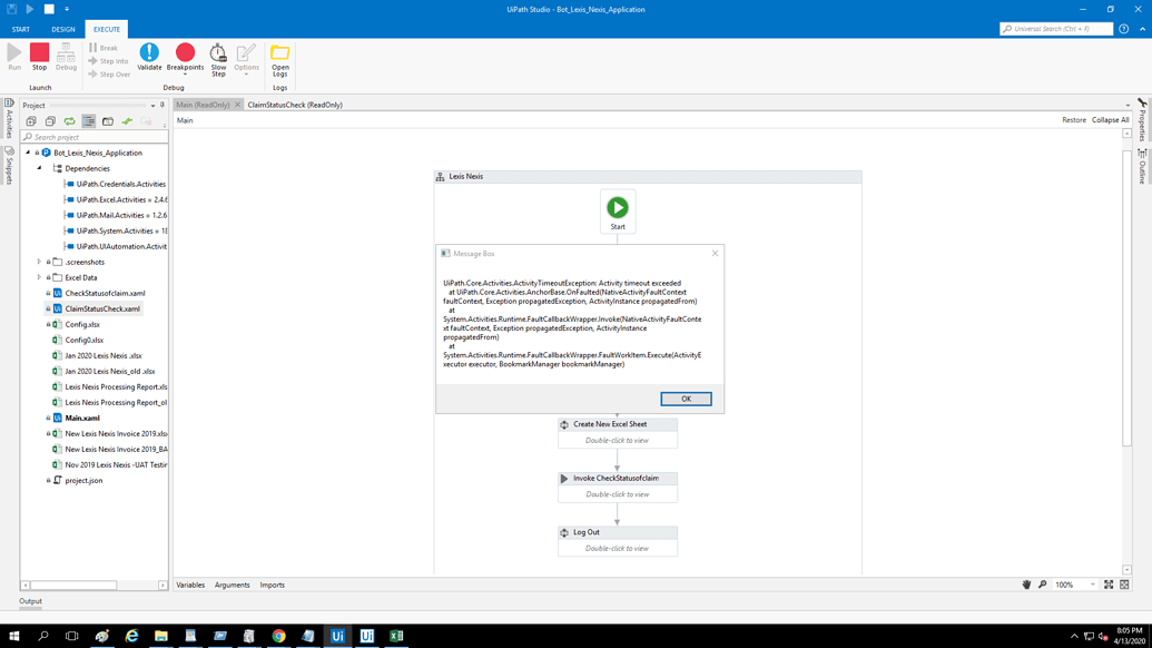

I have 1000 record in .I am inserting data in website.Almost 150 records its work fine.but after this not able to click.I used anchor activity as mention in attachment its works almost 150 records and I also try check activity but this not work even single record.
When my system locked it insert some data after that check not work if I unlocked my system its work fine.As mention in attachment.

both the selector same.Actually I faced this issue when my system locked.when I unlocked it work as excpected
