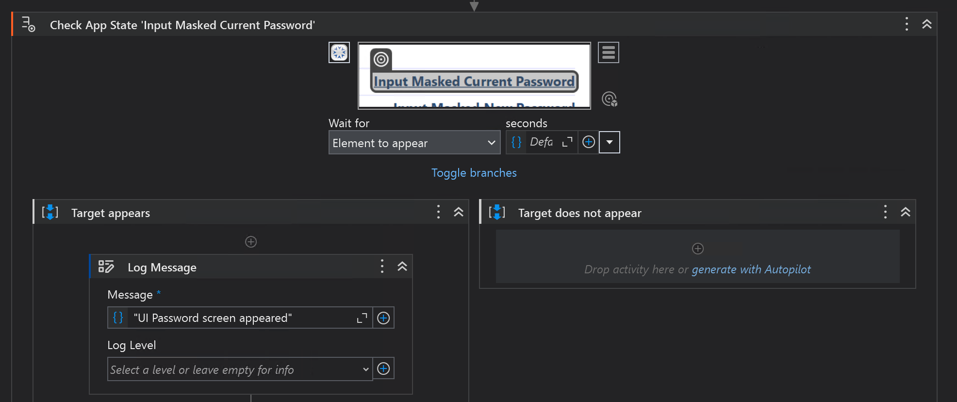

I frequently use Check App State to determine if a screen element appears and take different actions. I’ve used it because it’s a best practice rather than trying to click one thing and using a try/catch to handle it if it didn’t appear.

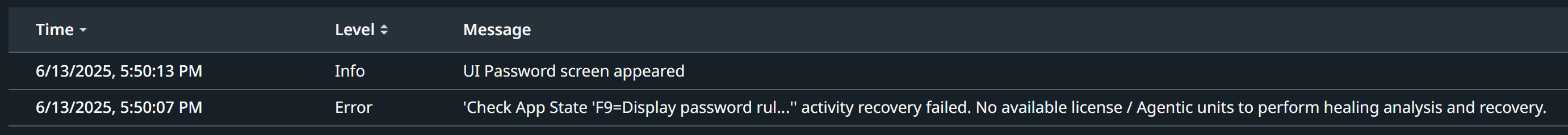

I just noticed this week after starting a new project with fully updated libraries that when the Check App State goes down the “Target does not appear” branch, it results in an error log which is somewhat confusing:
message:
‘Check App State ‘F9=Display password rul…’’ activity recovery failed. No available license / Agentic units to perform healing analysis and recovery.
The target appearing or not appearing is not an error that needs healing analysis and recovery, either is an expected outcome with different paths. That IS the intended use of Check App State, is it not?
This is happening in all cases where I am using Check App State and the “Target does not appear” branch is used.

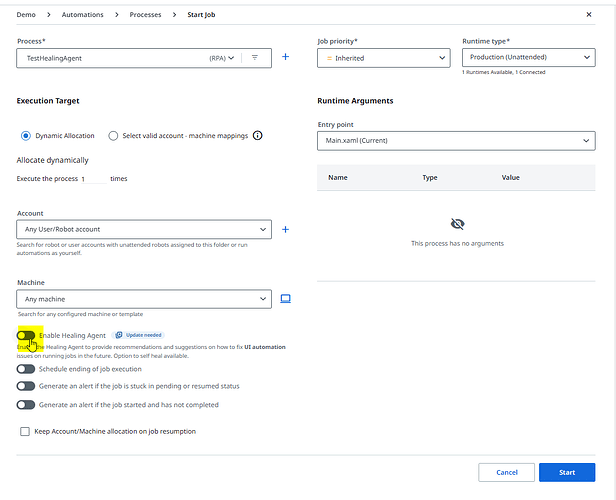

Can you try these:
  • This behavior was fixed in UiPath.UiAutomation.Activities.25.10.8 patch. The error message can be ignored, there are no side effects on the UiPath side.
  • Downgrade/upgrade and use UiPath.UiAutomation.Activities.24.10.14 patch in your project, as this version doesn’t require Healing Agent add-on.
  • Try to add "DisableActivityRecovery": true under the project.json file under runtimeOptions section.

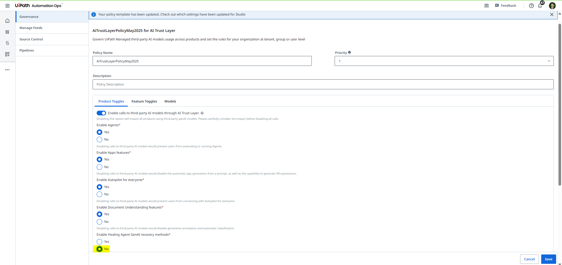

  • Disable the Enable Healing Agent GenAI recovery methods in the AI Trust Layer policy and deploy it.

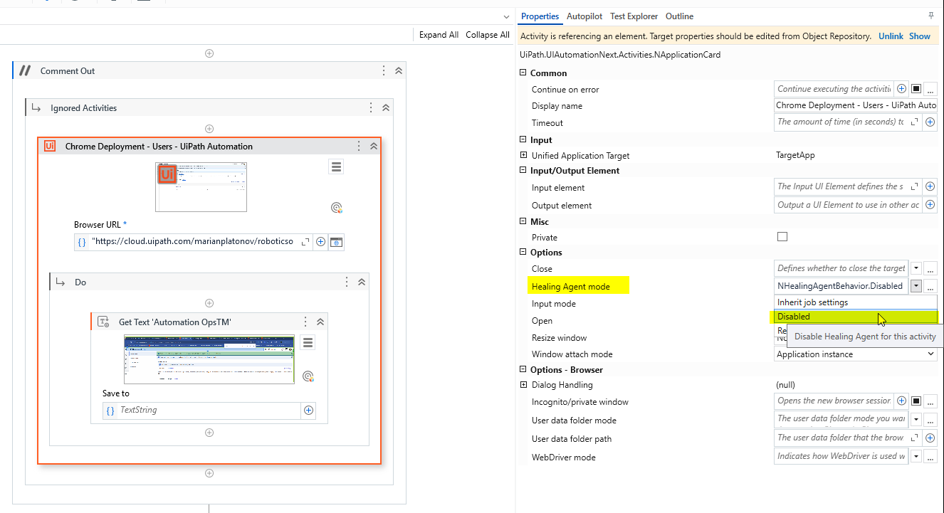

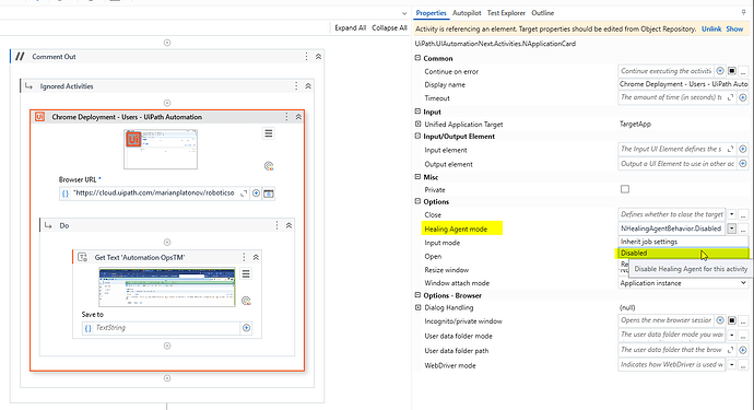

  • In the project, try to set to Disabled the Healing Agent Mode
  • Disable the Orchestrator notification subscription for Detected Job Issues via Healing Agent under https://cloud.uipath.com/YOUR_ORG_NAME/portal_/profile/notification-settings
The image shows a user interface with options related to healing agents and detecting job issues via a healing agent, including checkboxes and an 'Info' button. (Captioned by AI)

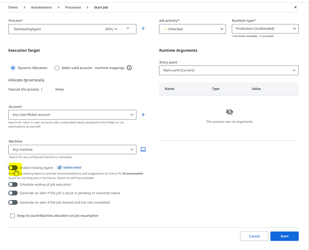

  • Under the Orchestrator Job, disable the Enable Healing Agent
