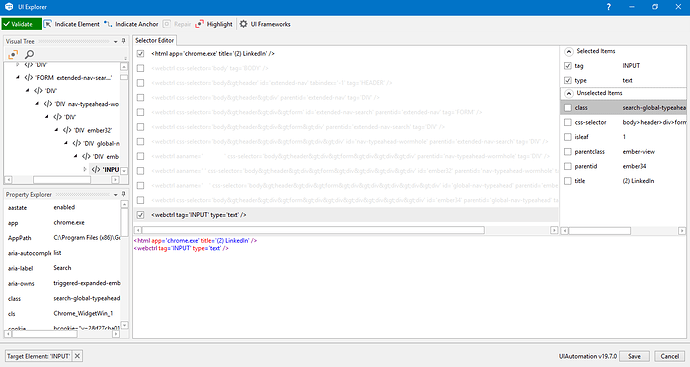

open ui explorer ,you can find the attributes in it.just check withthe aaname,idx make the idx to untick,just try with it.make it static one to be selected in attribute

If possible could you please send screen shots of about how to check with the aaname,idx make the idx to untick,just try with it.make it static one to be selected in attribute
@priyankavivek I am not able to get aaname attribute for linkedin.
Please find the below screen shot
just check with the attributes which changes dynamically so un tick those.make the other attributes to be static,this could solve your problem.
