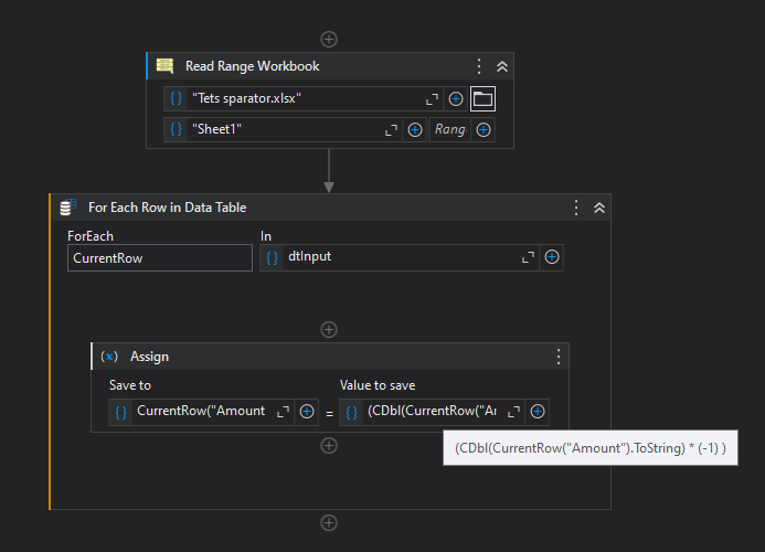

Hi @Lamina_Zafrullah
What about the following?
(CDbl(CurrentRow("Amount").ToString) * (-1) )
Regards!
Thanks @postwick But can you please walk me through the function to use.
I am using fill range activity to fill the column. Please note that I have both the positive and negative values on the same column. Please I am new to UiPath, what function will place in the what to write section of the fill range activity.
Thank you
Thank you @fernando_zuluaga . It worked perfectly. Thanks

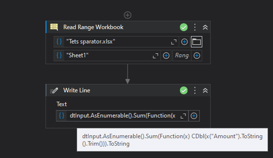

Hello @fernando_zuluaga please how do I do the sum total of the amount column
dtInput.AsEnumerable().Sum(Function(x) CDbl(x("Amount").ToString().Trim())).ToString
Thank you @fernando_zuluaga. After the sum-up, the final output ought to be positive. That is 190571872.419998 but it’s showing -190571872.419998. This is because all the values in the amount column are negative and I have changed it to positive. I am now surprised how the sum is returning a negative value. Please help
