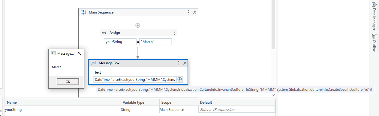

How about the following?
DateTime.ParseExact(yourString,"MMMM",System.Globalization.CultureInfo.InvariantCulture).ToString("MMMM",System.Globalization.CultureInfo.CreateSpecificCulture("id"))
