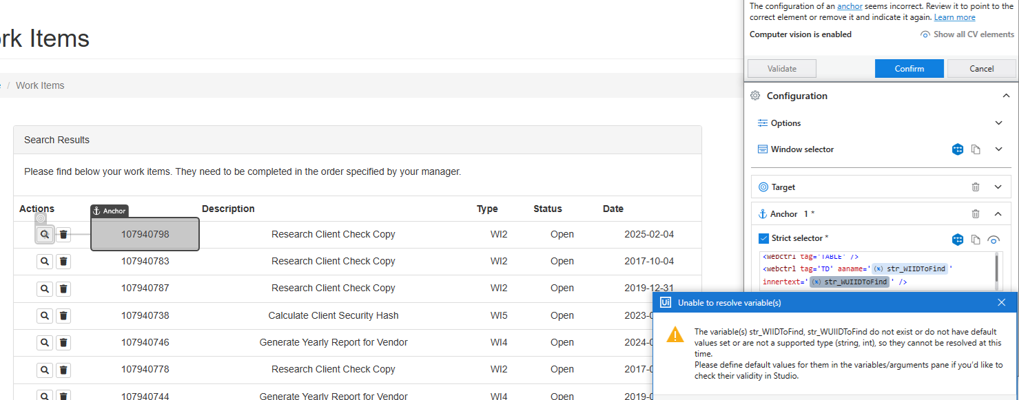

Can't use the Dynamic Selection to Click the right row
Practing on ACME, I already Extract the table on Work Items, already Filtered to WI5/Open items and now I want to click in the action button to see whats inside but only in the WI5/Open rows. I am trying to use the click activity inside the For Each Row, and my Sequence is correecly identifiying the page that the WI5 is (exemple, the first WI5 is only on page 3). But when the automation get in Page 3 it clicks…this first item on the table and not the WI5 one. I tryied everything, even Dynamic Selector. The With the Debug I saw the the variable is correct and have the correct scope (the For Each Row)
But, regardless of that error, I imagine that is because the str_WIIDToFInd is empity right now and when it reaches it, it wont be empity no more.
I dont realy know what to do. I just want the click to click only the rows that have WI5 and Open. And yes, the click is on the loop (the proof is that it identifies the correct page)

When using variables in the selector it will typically say that it cant find it because the variable is dynamic and throws off the value. To test it open, temporarily insert the value and check it can find it using the selector window.
I would look at updating the selector to include a “WI5” in it. You can add this by opening UiExplorer and then looking at the selector hierarchy and look 2-3 levels above the bottom selector. Find something that includes the text “WI5”
Hopefully this helps.
Hello @nands93
The screenshot shows the Anchor Strict selector, could you show us your Target selectors?
Regards
Soren

I used the target on the action button and put a wildcard on the id tag.
I ended up doing your sugestion and worked for me. Cliking each one would take much longer. Thx!
