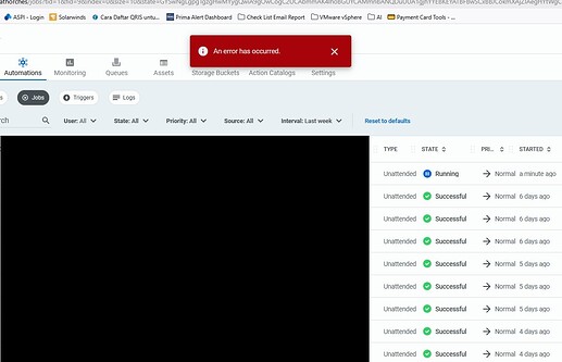

Recently, I encountered an issue where I was unable to stop a running unattended process through the Web Orchestrator.
The process could only be stopped via UiPath Assistant.
Other functions, such as starting processes or running triggers from Orchestrator, were still working normally.

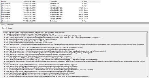

When checking the Event Viewer, I found that every failed job showed the following error message:
“The given key was not present in the dictionary.”
I realized that this message refers to the RobotId, but I couldn’t identify which database table the missing key is related to.
