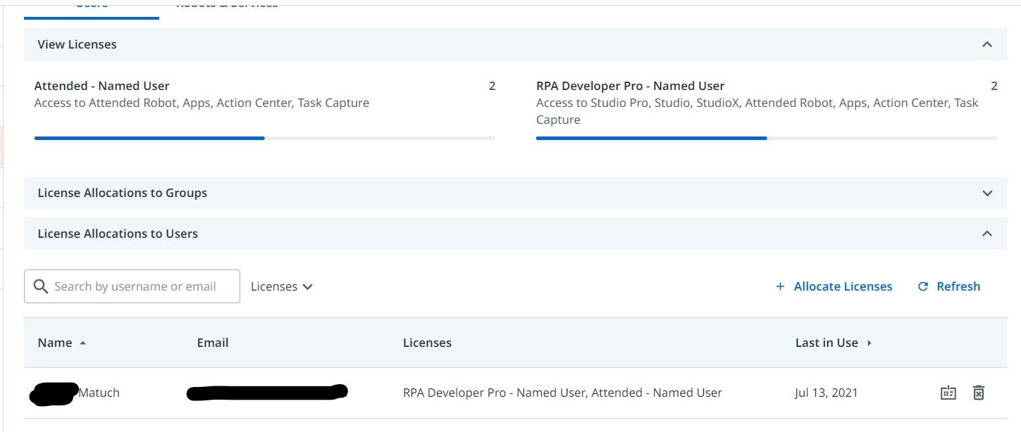

  2. I currently have no license associated with my profile despite manually assigning one.

Furthermore, I am now getting these two messages that I am “unlicensed” despite clearly being assigned a license in Orchestrator.
