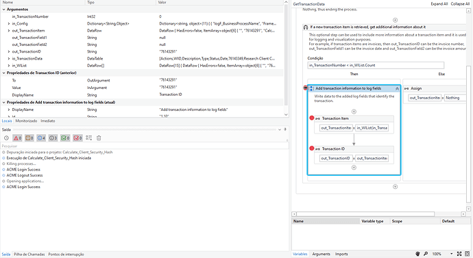

This is because WIID var is being affected with 0 as I discovery the out_TransactionID is populated with null value and I cannot understand why.
out_TransactionItem = in_WIList(in_TransactionNumber)
checking the vars
we can verify that is populated as DataRow, the magic happens on out_TransactionID
out_TransactionID = out_TransactionItem.Item(“WIID”).ToString
Which will appear to be null
As I saw this as a suspected behavior I decided to put a Message box after it
With the same sentence… The result was the following
So, is this a bug on Studio 2021.10.0 ?
This is my GetTransaction flow

Do you have both a variable named out_TransactionID and an argument named out_TransactionID? From the sceenshot you uploaded of your getTransaction flow, it looks like you have a variable called out_TransactionID which has been assigned a value of 76023818 (the number I believe you are attempting to assign). You also have an argument called out_transactionID that is assigned null, which is what I believe you are talking about.
Its possible this is what is causing your problem. You might want to try removing the variable and seeing if the argument picks up the assign once that is done.

Hello Ben, yep It did ok :wink: Thanks mate you sorted out
After remove the variable leaving only the argument it became populated with the expected value.
