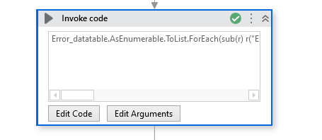

Error_datatable.AsEnumerable.ToList.ForEach(sub(r) r(“Entity”) = If(Global_Dt.AsEnumerable.Where(function(x) x(“Name”).ToString.Equals(r(“Employee Name”).ToString)).Count>0,Global_Dt.AsEnumerable.Where(function(x) x(“Name”).ToString.Equals(r(“Employee Name”).ToString))(0)(“Location”).ToString,“”))

Hi @Kancharla_Mahija
In the Invoked arguments, give the below way and try.
Use Write Range Workbook and pass Error_datatable to write the output to new sheet.
Hope it helps!!

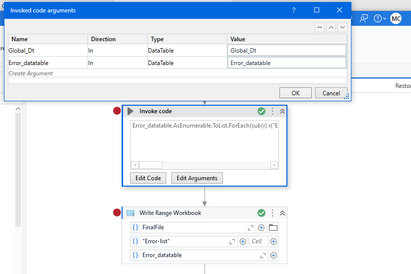

@Kancharla_Mahija
Errordatatable should be in/out…please change…I have given in previous post also
Later write the datatable back
Give the direction of Error_datatable as In/Out then, it will work.
Try this code in Invoke Code:
Invoked Arguments:
Output:
xaml:
Sequence14.xaml (8.3 KB)
Try running the above workflow. Change the excel files paths in Read Range and Write Range. Check and let me know if it’s working for you.
