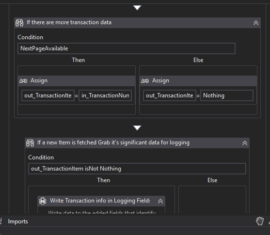

thanks.this helps a lot. in 2nd point how to return id of the first record to the main flow?

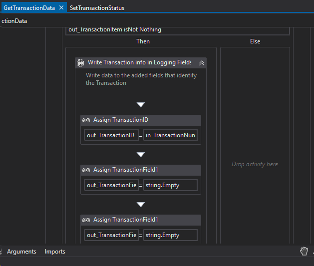

So as I explained, in the 2nd point, all the work will be happening in the Framework\GetTransactionData file. In that file, you will be doing the data scraping first. Then there are set of activities which are presented to you through the framework itself. That is the point where you initialize the output arguments. There are couple of things that are done by them as well for the use of the framework. We can tweak those a bit and pass the record ID to an output argument so that it will be returned to the main workflow…
Screenshots I have attached describes the section that I’m talking about… This is actually from one exercise I did to return the page number of a grid. So what happens there is,
  1. in the GetTransactionData file, I extracts the current page number and returns it to the main flow.
  2. Then in processing state, I do some data scraping to extract the data in the gird of the given page…
  3. Then do the processing,
  4. and increments the number through SetTransactionStatus…
  5. Then it goes back to the GetTransactionData file, checks and get the next page number… and the process goes on…
You can follow a similar approach to get the process running!! Just explaining a similar scenario for you to easily fall in line to get your automation working :slight_smile:
