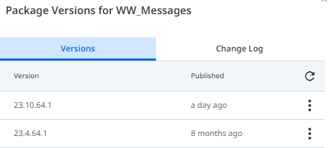

To your first question => yes, we have published WW_Messages with 23.10.3 like robot’s packages:
