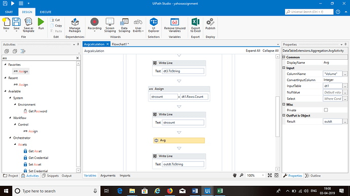

Why is outdt an Object?
output of the avg is Object. I used direct avg activity. and im getting the correct value.
Got it.
capt
I think you should add .ToString
i tried still getting error.
Use Write Cell instead of Write Range :slight_smile:
