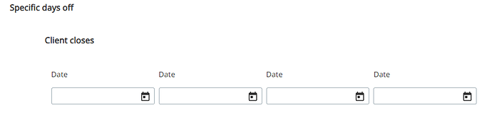

I want to build an app to handle specifit dates and time slots for a client’s time managing purposes. It has many sections like the following:
Here, in order to build a table and insert the values, I use an expression like official docs
Where I insert in each row the resulting date selected, it prevents me to create many single variables to link to my process arguments.
ISSUE
I just have an issue with the empty values so, if I set ALL DatePicker components with a default date, I don’t have any issue but, I don’t want it to have presets, I just want to have them empty.
The issue itself is that, when there’s a non-picked date in any of all datePickers, I get a whole empty table in my assistant. It’s a pitty the very short description we get in DatePicker

Looks like when empty the value is expecting datetime but because it is empty it is failing…what you can do is check for empty value and then assign a default date like 1/1/1900 insteqd of the actual value
If(FormA.Cliencloset1.Value.ToString.Equals(""),"1/1/1900", FormA.Cliencloset1.Value.ToString)
Hi, It works!!!
Thank you so much for the christmas present :smiley:
