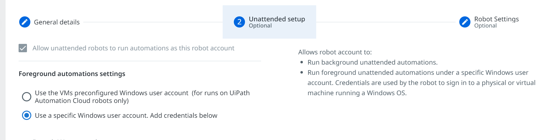

Are the settings on orchestrator for robot include login to console to be enabled and set to false?

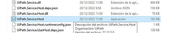

@Anil_G
Do I have to do something with this?
Anil_G
(Anil Gorthi)
February 24, 2023, 6:33am
8
@gruano1
You need not…it is to check if UiPath is installed in service or usermode…
As stated…can you logoff/signout and yhen run the bot and check please

Please I need help with this:
I have the service mode installed
The robot runs while the session is not started.
I don’t know what to do, I keep having the same errors
