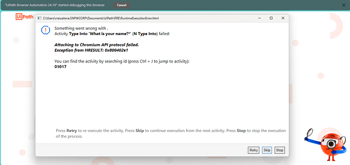

Hello everyone, I’m using studio X.
upon using type into activity in application browser there’s an error
I already uninstall the extension file of edge tool, but same error.

Could you please check the properties of type into activity to verify if you have set the input mode under Options as “chromium api”?
If yes, kindly change the option to same as app/browser and then try
