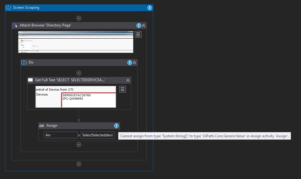

I can screen scrap the below box on a website and it will output both text elements if I write the screen scrap variable using WriteLine as shown.
I need to be able to use each text line as a variable later on in the sequence.
So I could make (SEP001…) into variable1 and (IPC-QX…) Into variable2
I’ve searched and can’t really wrap my head around how this would be done.
Really i’m needing to have the program tell where the SEP00… text is located in the list if it’s on top or at the bottom or in the middle of the other text elements. This way the program can choose it and continue on. The only way I found to get the text from the box was with a screen scrap.

Hey @anmolk171
That seems to be what I need to do but I’m getting the following when I try to assign the variable that was made when I did the screen scrape.
I’m doing Arr=SelectSelecteddevicea.Split(Environment.NewLine.TocharArray)
SelectSelecteddevicea was the variable the screen scrape generated.
Hi @Nerd,
Can you please share the workflow if not then make sure SelectSelecteddevicea variable must be string.
Best!
Anmol
@anmolk171 You had it right! I missed making it a string instead of just a string. That worked. Thank you for the help!
