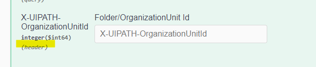

Hi @Parth_Belsare
To fix it the quickest, I think you will just have to check the requests made by Orchestrator UI in the Network tab of your browser console.
If I recall correctly, this is because the Organization Id should be a header value. A quick look at any request made by Orchestrator in the browser should quickly clear it up for you :slight_smile:
orchestrator_url = “https://cloud.uipath.com/parthbelsare/DefaultTenant/orchestrator_/odata/Jobs/UiPath.Server.Configuration.OData.StartJobs
This is the url I have entered in python code to trigger the bot. Should I change this?
@Parth_Belsare
the url is correct but the org id should be present in header and not payload
Also better to first do a call from swagger or postman to know the correct details
<OrchURL>/swagger/index.html
cheers
