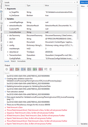

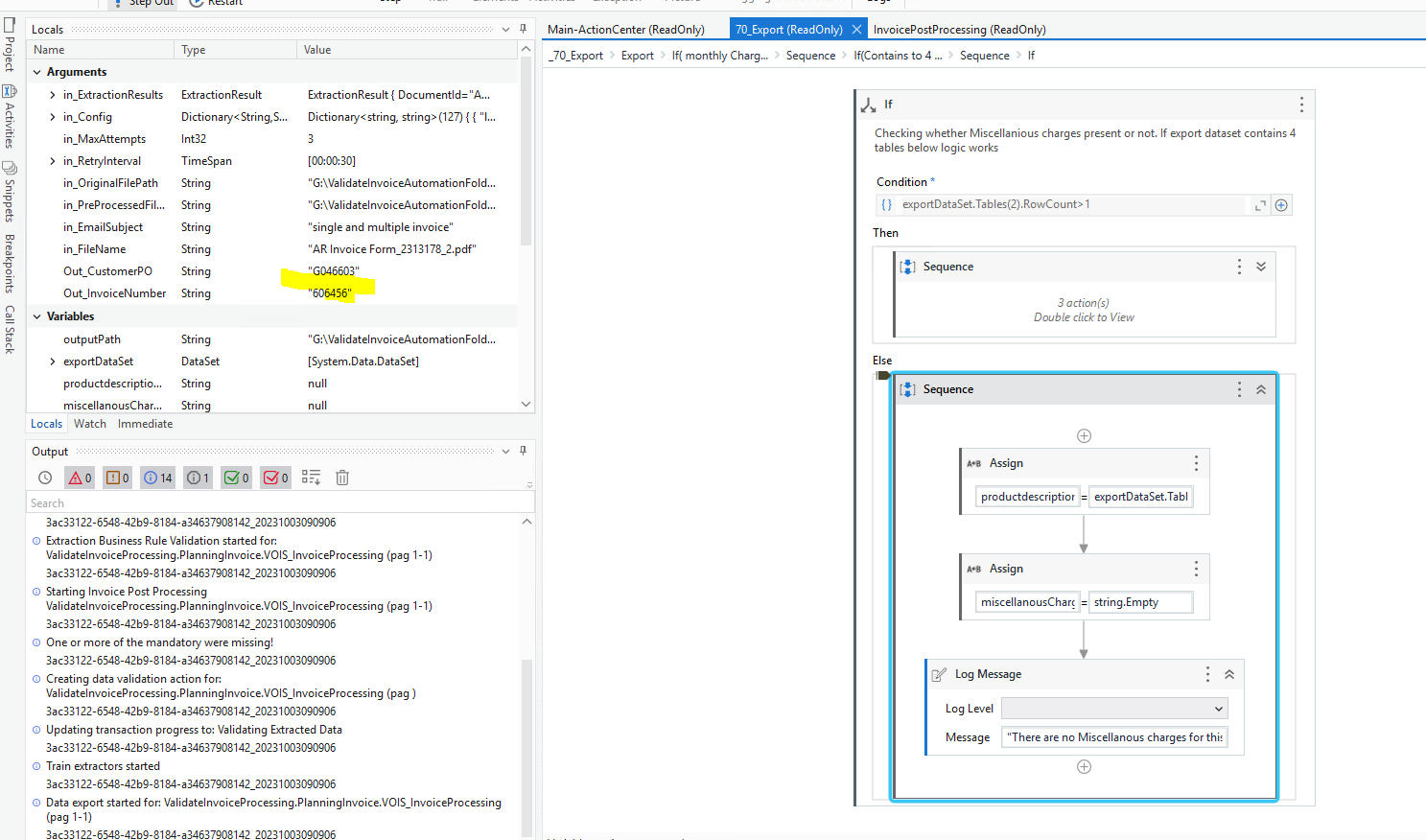

Put a Log Message activity after your Multiple Assign, and put a breakpoint on the Log Message activity. Run your process in Debug mode. When it pauses on the Log Message, verify if OUT_InvoiceNumber and Out_CustomerPO have values.
Yes it having values all the way to that xmal. Once i came out from Invoke Xmal thats where the values are becoming null. Basically i was extarcting these values from DU extarction table. That table is only exist in Export xmal. Once i stepped out from that xmal we don’t have access to that datatable
I was thinking because of that Main table argumenst are not passing outside of the table
It has nothing to do with the datatable.
Do the Debug suggestion I gave you and post a screenshot of the values in the debugging pane on the left.

It has values after coming out of Multiple Assign
Now can you place a log or breakpoint in the main-actioncenter file after your workflow is being invoked. and also check for same named arguments and variables in main-actioncenter
Basically am throwing an exception after that will that cause any issue
In your Main xaml, using universal search, search the variable names and see if you have them declared more than once.
It won’t pass the values if an exception is being thrown from your invoked XAML.
IF you need those values you would have to pass those values in your exception message.
something like
new BusinessRuleException(“invoiceNo:”+out_InvoiceNumber+“;CustomerPO:”+out_CustomerPO+“Unable to proceed due to some reason.”)
new Exception(“invoiceNo:”+out_InvoiceNumber+“;CustomerPO:”+out_CustomerPO+“Unable to proceed due to some reason.”)
