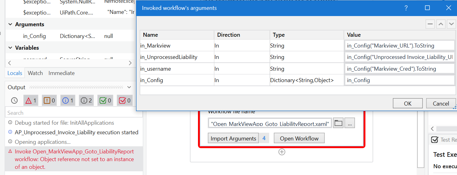

Hi All,
i am trying to open website by reading values from config file.

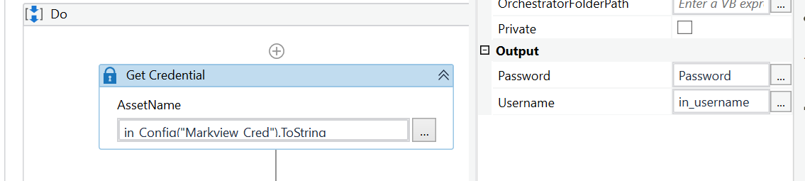

i have created one workflow and created few arguments and then used get credential activity to get the credentials from orchestartor.
After that i have used type into activity to type user name and paswword and from property panel i passed the argument and variable which i created on above img.
now, i have invoked this workflow in initAllAplication workflow, but it is failed.

yes, i have copied in_config argument from initAllAplication workflow and used in current workflow and used this argument in get credential activity to read the value from config file
yes, but you are not receiving any value, please check when invoking the in_config argument, if it is in the proper direction, also if you are passing the correct value, this argument cannot be null
