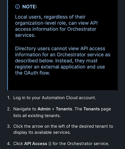

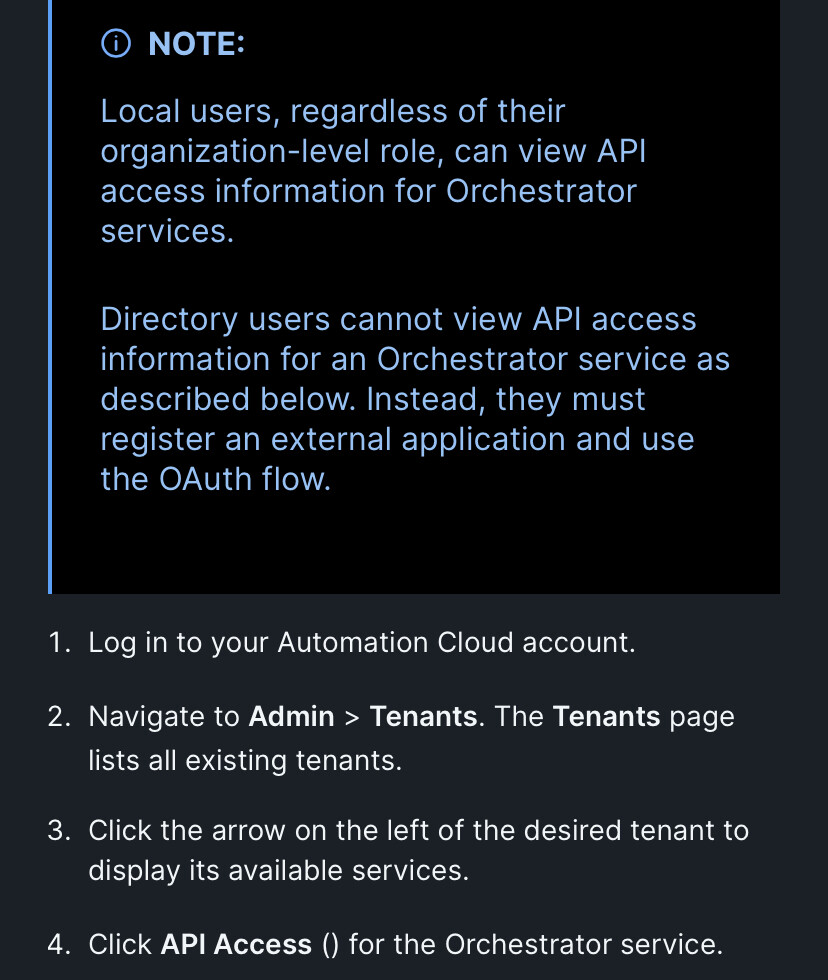

Hi
check this documentation for orchestrator API access https://docs.uipath.com/orchestrator/automation-cloud/latest/api-guide/consuming-cloud-api
Try the below steps are as follows:
  1. Clear cookies and restart the browser.
  2. Login to Automation Cloud.
  3. Navigate to Admin. Click on the Tenant whose Orchestrator service API access is needed.
  4. For the Orchestrator service, please click on ‘Manage Access’. You will be redirected to the Orchestrator service for the tenant.
  5. Navigate to Admin again. Click on the Tenant whose Orchestrator service API access is required.
  6. Click on API Access for Orchestrator. API Access screen will be displayed.

Double-check the provided solution and don’t skip steps. It should work.
Also, you can create an external application for your Orchestrator API resources.
