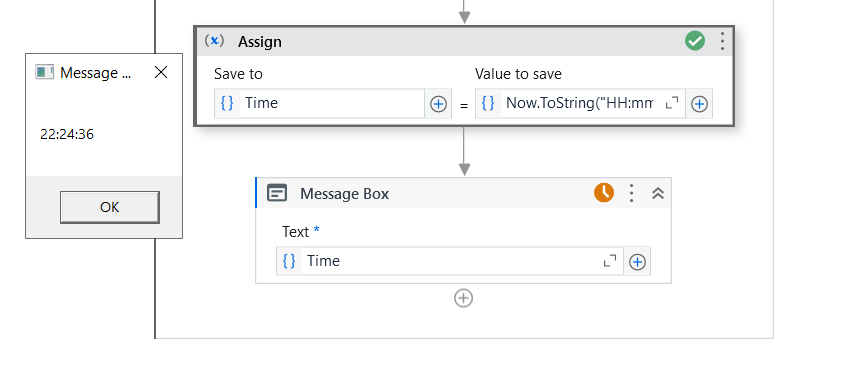

Hi @egemsac
Welcome to Community!!
Now.ToString("HH:mm:ss")
Cheers!!

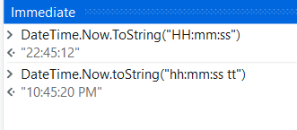

Hi @egemsac
You can use the below,
To get it as 24 hours time format
DateTime.Now.toString("HH:mm:ss")
To get it as a 12 hours time format with AM and PM
DateTime.Now.toString("hh:mm:ss tt")
Hope it helps!!
