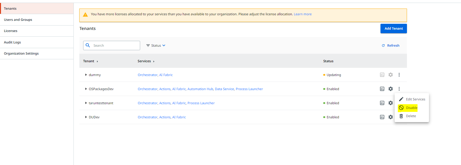

Hi Aram
Could you try disabling the tenant entirely and then enabling it again and see if that solves the issue?

Good old ‘Turning it off and on again’ method remains king, it seems :wink:
Problem solved. Thanks Jeremy!
