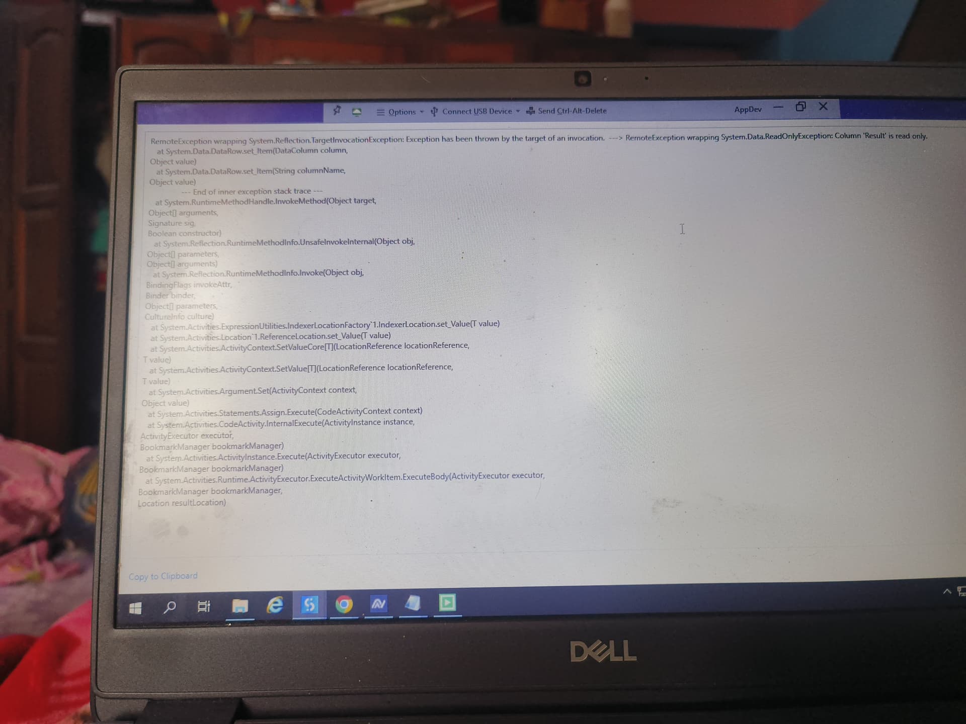

Thank you for your support but not sure y I am getting error
Exception has been thrown by the target of an invocation

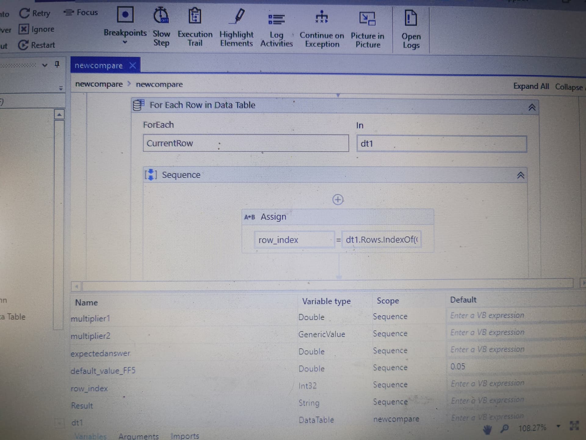

Then show me the “Locals” pane on the left side of the screen
Below is the screenshot
Try swapping “row” to “currentrow”.
It needs to match the variable from the For each row activity.

But unfortunately it’s not working
I found the reason but don’t know how to fix
The error is coming because I am trying to write “True” to the Result (column 4 as per your XML)
But if I write the same to a new column then it’s working
Is there something that I need to do get the Boolean value printed to Result
i.e as the column “Result” has already got True printed in some of its Rows that is the reason row(“Result”) is not working and if I am declaring a new column row(“Result1”) its working
Hey
When you added the column “Result” what type of column was it?
