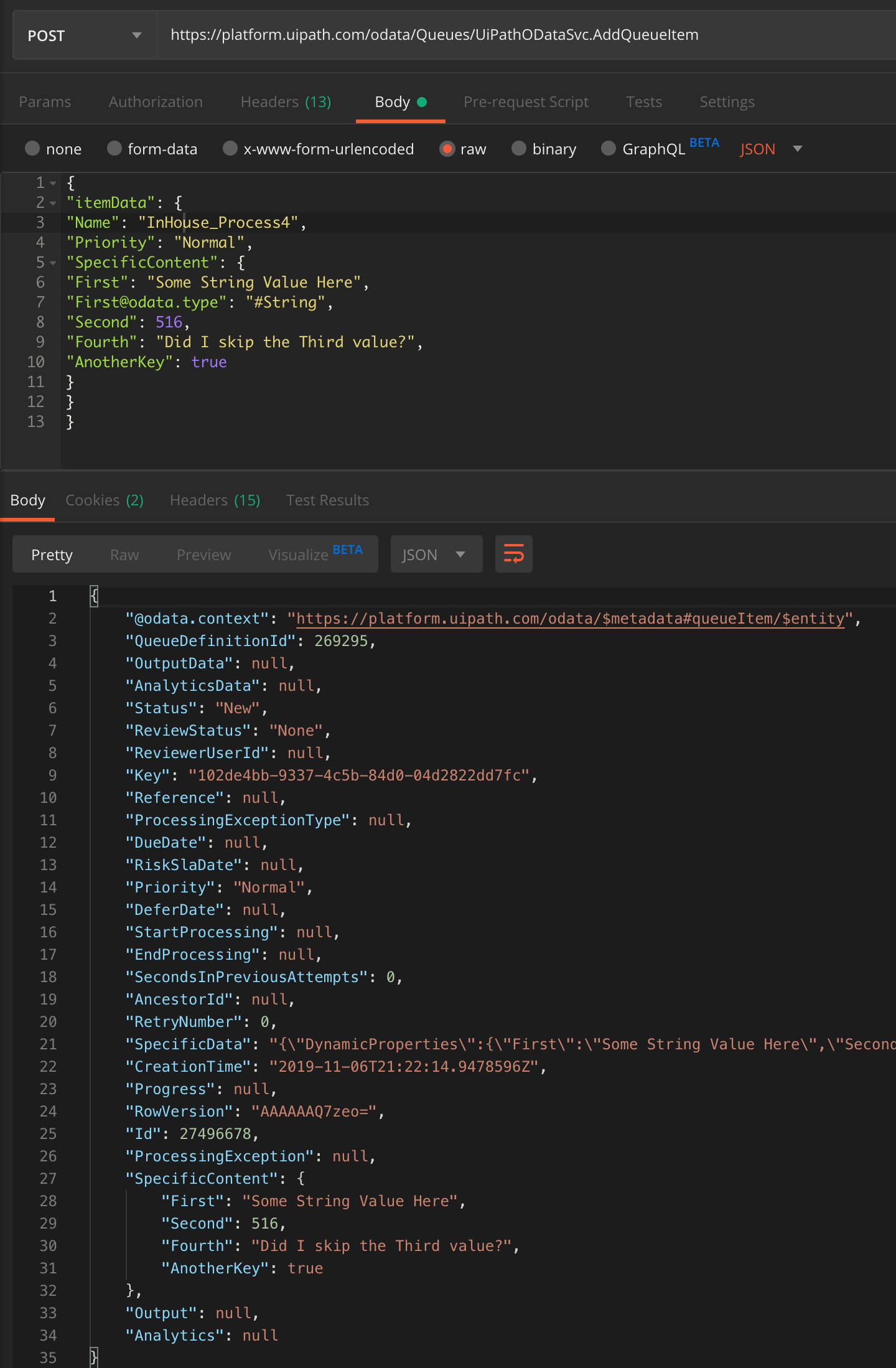

The base API Call works using Cloud Orchestrator 2019.10 (My current version @ platform.uipath.com). It is certainly without the “()”.
I took your body, and changed the Name property to the name of a test queue I maintain. Put it into Postman, and it worked.
I do not know if there was a bug in Orchestrator 2018.2.3, but the API request absolutely works in 2019.10.

Attached are my headers from Postman, though, remember I am using the 2019.10 Cloud Orchestrator. that means i have the latest version of the REST API and Orchestrator. If you are on 2018.2 (Like I think you are), your headers probably won’t include the FolderPath or the TenantName, but might include the OU.
– M
