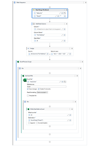

I have a column A, B and C. I want to add a new data column called “Full Address”.
How can I do this using LINQ? where to add new data column and data contains combination of column A, B and C.
Refer to the image. Above is before, below is after. Actual data rows is huge, therefore wanted to use LINQ

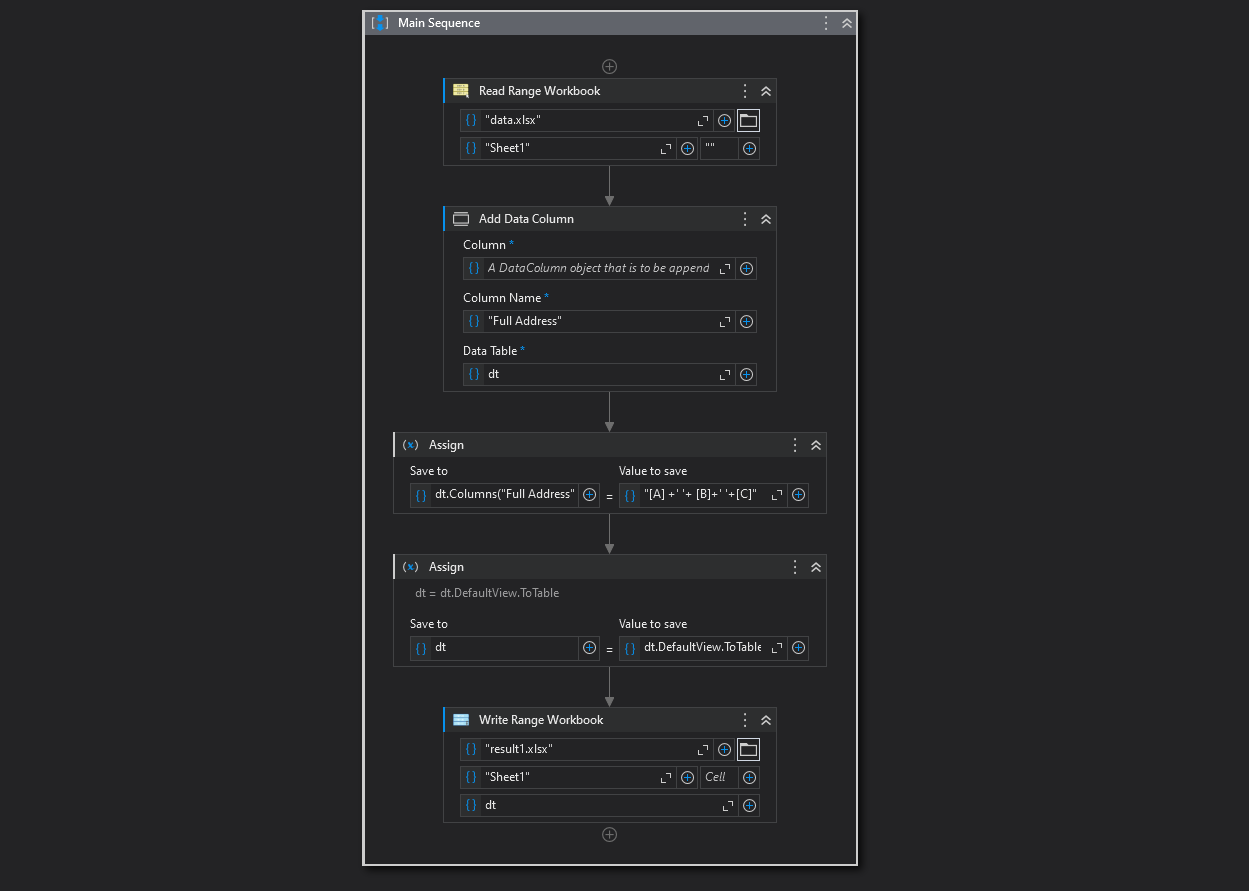

Hi @aqiffm , I made a small change to @Yoichi 's solution, just in case you want to avoid using Excel (to make the process faster etc).
