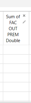

Hello guys i have created a table using build data table in which below column is double
Here the below marked value are decimal values while adding it the add data row and write into excel it is not giving the decimal point only the rounded figure.

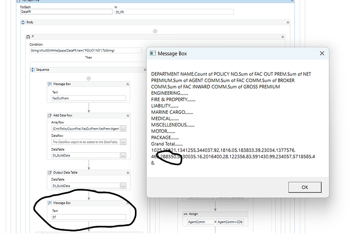

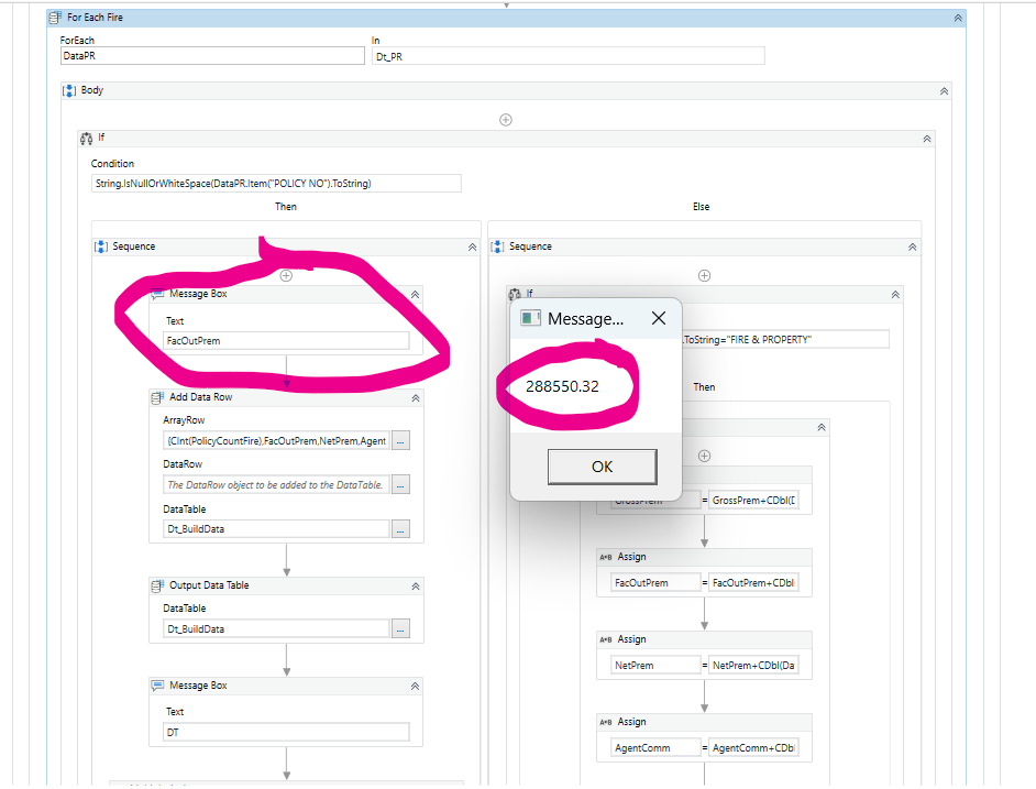

I have used message box for that variable it is giving values with decimal.

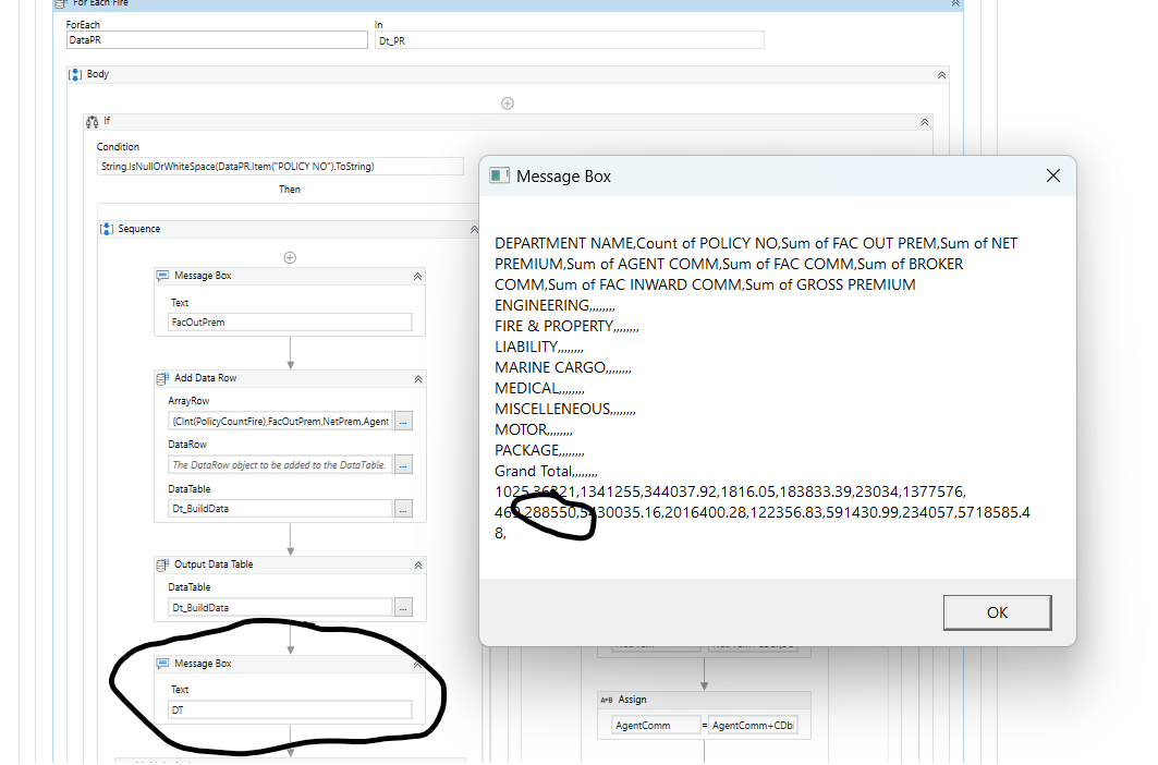

2.I have used output data table and printed it, same it is giving the rounded value.

When i printed only the variable it has decimal value like above
So when added that to that datatable and printed using Output data Table the value is rounded

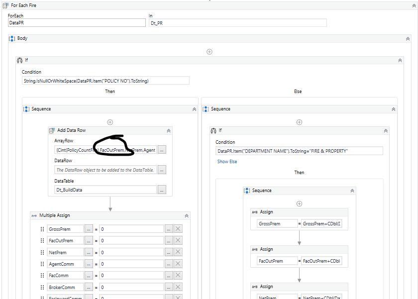

Guys I got the solution,
Its because iam using one column as int type in build data tabe activity accidentally the data is adding to that column
Now i have changed that to double
