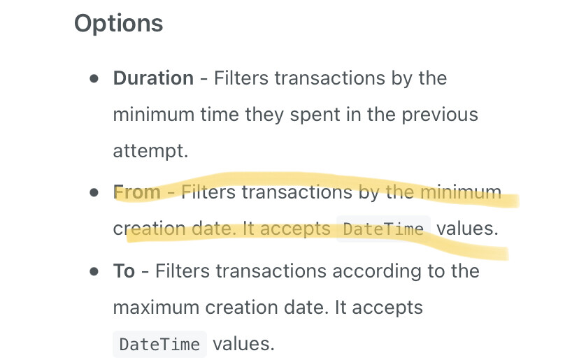

Hi @Anil_G thanks for that.
What will be the format of the start time? And how will I add it in the Get Queue Item activity?
@redanime94
Format of start time is a datetime variable…at the start of the process store the value of Now to a datetime variable and you can pass it directly.In get queue items there is already a field for from …that is where we add it
