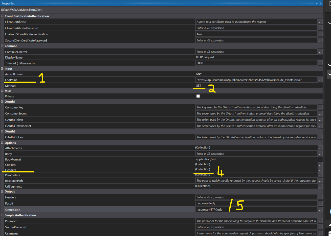

I have configured the request based on this example on the GitHub page:
And Here is the configuration of the HTTP Request Activity in Studio below:
Step 1 & 2:
- Comes from Step 1 above which is the example URL (and an example Robot Id as shown on the documentation above)
- Only Request types GET and HEAD are supported by this API call
Step 3 :
- Per Step 2 above, you have go to a separate page to get the HMAC SHA256 signature output
- I used this page below to generate the hashed output as directed by Step 2 above
- Note that the plain text must be the segment of your URL (and this will change with every URL you use)
- The Secret Key is your API Secret Key (not the API key)
- Once you hit the Compute Hash button, you will get the Hashed Output that you will use in Step 4 to configure the HTTP Web Request in Studio

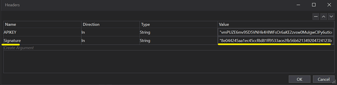

Below you will add Headers to the HTTP Request as shown here:
- The APIKEY is your API Key (not your API SECRET KEY)
- The Signature is the Hash value you generated in the previous step

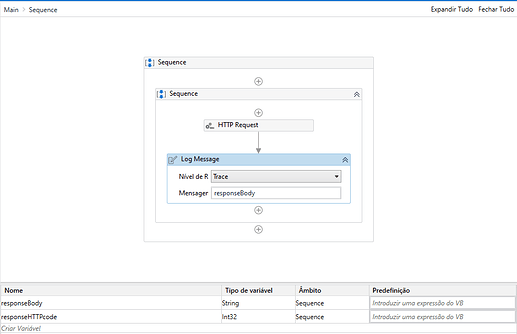

Step 5:
Finally, you will add variables to receive the response and response HTTP code based on which you can decide your downstream process:

I’ve tried and stucked in here:
The responseHTTPcode is a 403
Just looking for some kind of response that I could desserealize or something.
Thanks
